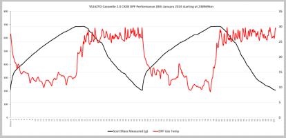

Hmmm.... looks like the log is an earlier one as it stops at 238907 km.
Thanks for sharing - very intriguing data!
Anyways, the same phenomena can be seen - e.g. below from 238579 km to 238763 km = 184 km, 2 hours.

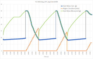

Plotted the two soot mass parameters (calculated & measured) which are used by ECU to monitor and trigger DPF regeneration.
Normally "soot calculated" (blue) is the dominant one. Here it's a kind of opposite. As soon as "soot measured" reaches the DPF regeneration trigger level (30 grams) also the "calculated" is jumped to 30 grams which then forces the DPF regeneration to start.
I think "soot measured" is actually measuring/estimating DPF blockage level - by actually measuring differential pressure across the DPF.

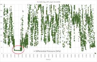

The level area in "soot measured" at from 11660 to 12090 seems to be a period at standstill engine idling - took advantage to verify differential pressure across the DPF at stable conditions - turns out to be a stable 25.1 hPa (which is quite high). I guess the clogged DPF is the culprit for the too frequent DPF regenerations - ECU sees too high differential pressure and triggers the DPF regeneration to clean the blockage.
Noted that DPF oil ash residue has been reset and currently value is only 2 grams which neither corresponds the mileage of the vehicle nor observed high differential pressure. Wondering if the discrepancy between differential pressure and DPF oil ash value confuses the ECU???
