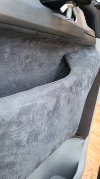

So I took the plunge. I managed to grab some california door cards for £100 on the bay, looking a little worse for wear IMG-20220718-WA0004.jpeg
So having never done this before here goes and likely to have got parts in the wrong order
First I used a dremel to remove the plastic welds however I couldn't fully get the fabric panel off so what else to do but skin it whilst in place!
Next was to paint the remainder of the door. Watched some YouTube and went for whitewood, sugar soap and panel wiped just to give the surface a key for the paint
Ran off to the local pound shop for tins of paint that aren't a pound! False advertisement eh
Anyhow a few hours this morning and here's the result
Note to self don't use satin paint as it contrasts to much with the factory colour however a few dusting of matt black and I was happy with myself for 3 hours work and approx £10 in materials!
Finished off with 2mm silentcoat on the rear and 6mm noise barrier ready for the audison setup
So I took the plunge. I managed to grab some california door cards for £100 on the bay, looking a little worse for wear View attachment 165690
View attachment 165693View attachment 165694View attachment 165695
Here's a contrast image View attachment 165696
