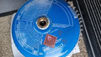

Was just reading elsewhere about weighing the gas cylinder to tell how full it is but a bit confused by the labels. It's a blue 904 cylinder and says 1.8kg on the top - I think this is the weight of the gas only when full?

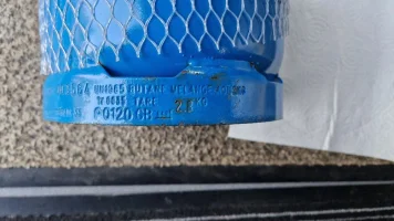

20250413_173605.webpElsewhere on the bottle base it says 2kg and then 2.8kg (see photo). One of these numbers must surely be the empty weight?
The actual weight currently is 3.6kg. I think either way, it's not empty but would like to understand which number is correct.
2.8kg is the tare weight, i.e. the weight of the bottle when completely empty. It can take 1.8kg of butane, so should weight 4.6kg when absolutely full. Yours, at 3.6kg should have 0.8kg of gas left in.
Thanks. So 44% full.
