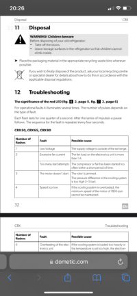

We are away in Europe and have realised our Dometic CRX has stopped working properly.
The lights are on but we can’t hear the compressor anymore. There is a red flashing line and looking at the manual this only flashes once and then there is the 4 second gap. This comes up as a line voltage issue and possibly that the supply voltage is out of range.
We were on EHU. I tried turning it off by the power button inside the fridge itself and then removing the EHU cable so that it would be running off the leisure battery and turning it back on but it’s still doing the same. Leisure battery is relatively new lithium and having no other issues with it so far.
Any ideas on possible fixes we can do to resolve please? Did try a search but couldn’t see this exact issue elsewhere. Thanks
