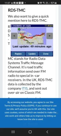

The T6 satnav uses RDS-TMC for traffic information.
It's sent over FM broadcasts.
It's not as accurate as Google maps that uses a live data connection.... But it's good enough for long jams.
