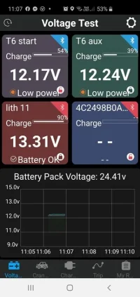

this is the BM2 readout for the starter battery.
you can see the 3 stages boost, abs, float from the victron charger.
this is the BM2 readout for the AUX battery.
here you can see an initial boost stage . . . then 13.2v float stage. (battery was charged already)
this is the combined BM3 readout.

here is the power logger for a more "normal day" . . . .
this is the setup . . . Redarc DC-DC with Anderson connectors and a BCM/RUN feed.
here is the starter battery:
Screenshot_20200509-110808_Battery Monitor.jpgScreenshot_20200509-110759_Battery Monitor.jpg
and this is the AUX battery:
Screenshot_20200509-110831_Battery Monitor.jpgScreenshot_20200509-110827_Battery Monitor.jpg
and this is the BM3 combined chart . . .
Screenshot_20200509-110737_Multi-Batt Mon.jpgScreenshot_20200509-110730_Multi-Batt Mon.jpg
you can see the start/stop effect on the starter battery . . . .
and the good solid operation of the Redarc on the AUX battery . . . .

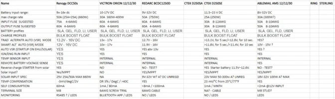

ABLEMAIL AMS 12/12/30 ADDED
Can anyone with these help fill in the missing data?

for the test below the charger was connected at 8am and disconnected at 3pm. . . . .
