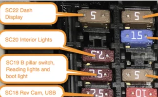

I now have the same error light on my dash. I was removing my cab headliner today and now that I’ve refitted it (after trimming it) my courtesy/reading light doesn’t work. None of the 3 bulbs in it work and either does the sliding door courtesy light work now. Could I have blown a fuse or something? (No idea where to even start checking that
Internal lights fuse SC19/20, could be, check these 7.5A fuses (top left)
@Loz I was struggling to cross reference your photo to what I could see on my fuse box but assuming it’s the one below the glovebox I checked every fuse I could reach through the wee hole and none of them were blown. Is there anything else I could check?
Yet another variant... Which year/model is yours?
Mine was first registered September 2015. Ended up being the fuse marked " SC5 Parking Lights Interior Lights MY18" on the fuse diagram you created
