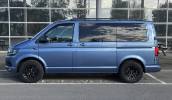

If you want to remain at factory height (as I did) I'd probably keep the factory springs and in order to reduce body roll in the corners I'd think about H&R Anti Roll Bars coupled with the Koni dampers that you're interested in.
Just my opinion, it worked for me.
I'd probably speak to a suspension specialist such as @CRS Performance who can give you good professional advice.
