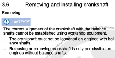

Not really helping but the following can be found in 2022.11 edition of Workshop Manual (but not in the earlier editions - e.g. in 2019.03)
Thank you for helping, unfortunately the link or picture I’m unable to see.
I have the 2019.03 workshop manual
Reactions: mmi
No linky for me either….just a box and a question mark. Doesn’t do anything clicking on the box or ?
Reactions: mmi
Thanks for reporting - indeed, nterestingly the picture is missing when I'm not logged in but when I'm logged in I do see the picture (on Windows Firefox, Edge, on Android Chrome, T6Forum App, Firefox).
Anyways, a new try below - any better????
