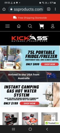

I used a 9 stage kickass battery charger in my house so no issues there.

I love the KickAss stuff and Redarc....
If I was in Auz that's what I'd be using too.
It's not really available in the UK, though there are Redarc dealers here....
I have a Redarc bcdc1240 & bcdc1250d myself.
