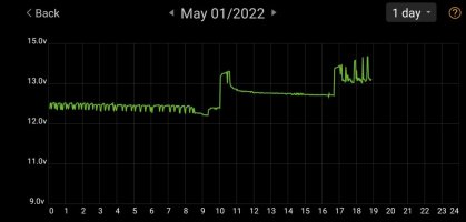

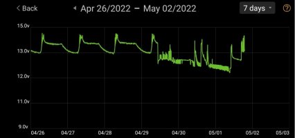

Erratic charging 30/4 & 1/5
More detailed view of 1/5

LOL, that's because it was the starter data, it must have switched when I was checking the history :rolleyes:. Correct leisure data added and starter below.
Charging from 10.00 to 10.15 looks fine - CTEK in bulk mode and leisure battery slowly rising. ( CTEK thinks leisure battery less that 80% charged)
No solar generation during the day.
Bulk charging from 4.45 to 5.00 ok.
Looks like a large load kicks in at that point and CTEK doesn’t sustain the voltage at this point - I don’t think this is a problem- the spikes look like the load switches off and on,and the CTEK continues in bulk mode - you can see each subsequent spike has a higher voltage as bulk charging continues .
I don’t think there is a problem ( unless there is no leisure battery load at 5.00 onwards)

That's good to know, but there was no large load bet 1645 and 1900... It was exactly the same load as bet 0001 and 0900.

looking back at your original trace, it looks like you’re continuously loading the battery from 29/4 . Is this a fridge or something which is switching off and on?
Also - where exactly is the BM2 connected? Are you measuring some voltage drop through some cabling?

It is a fridge that was running. Both BM2s are directly fitted to each battery... No cabling. The CTEK was fitted in a June IIRC, but it has never operated at that voltage since the first charging drop out.
