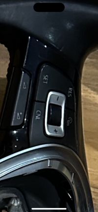

Hi guys and girls, I've trawled through the other retrofit threads but can't seem to find one that's similar.
2018 DSG shuttle SE, already has mfsw as standard but no cruise.
I'm assuming with the correct buttons and coding, all I'll need is the extra wiring to get it working.
Pic of wheel currently in the van.

You don’t have the correct buttons on the left for ccs. The buttons aren’t easy to find and are expensive. This is what you should have on the left.
