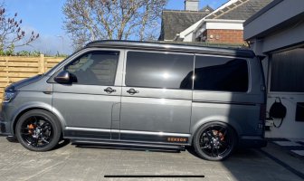

The wife did notice the van was "less bouncy" on the drive home but she now has less of a struggle getting in and out with the reduction in height and that she says was worth the money alone.
My wife (who is a secret petrolhead) noticed immediately when I got home. Within 30 seconds of her driving, she commented on the more assured handling. Her complaint was why VW let a California (with all the extra weight) out of the factory with the lightest of ARBs and it is for the customer to put it right afterwards given how much a California costs.

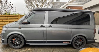

Another happy @CRS Performance customer today.
My van was generically ‘lowered’ when I bought it a couple of weeks back but I noticed straight away that it wasn’t quite right, besides from the looks:
At motorway speeds the van felt like it was being buffered by high cross-winds and around town felt as though it pogoed back and forth as I went over bumps. So I called Steve had a chat about what I wanted from the van and the fact that I had 275/40 R20’s all-round and we agreed on the H&R Coilovers with a sensible drop (65mm) with an option to upgrade the ARB’s at a later date.
My issues have been mostly solved, the pogoing had gone and there was only very slight occasional buffering on the drive back home - but it was windy to be fair so it’s probably just that? I suspect right sizing the tyres would help but I won’t do this until I’m due a set as the setup is now miles better and feels much safer.
