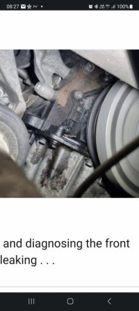

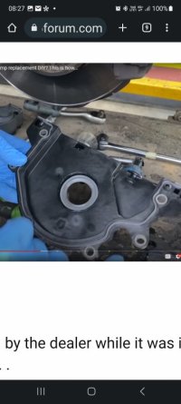

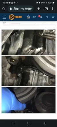

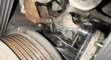

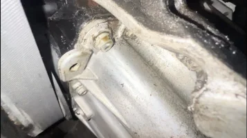

Hi there, I have a leak on my T6 2.0 102bhp engine, I looked underneath and it’s coming from the crank case oil seal, also I had my cam belt and water pump done (year and half ago) does any one know a good Vw specialist garage in and around Cardiff area please
The sump is a silicone seal.
The crankshaft is a bearing type seal .
Have a look at my post.
Post some pics of your leak to see where is coming from.
