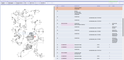

Finally, the problem was the EGR cooler. In fact, I bought a new version through the Automotive Ronald Morien Webshop (half price than others!), you cannot find the old ref either the new one in ETKA...
I did not need to perform any test because was obvious the water inside the exhaust pipes of the EGR cooler....
These are the references:
04L131512T(old-obsolete)
04L131512TX(old-obsolete)
04L131512CF(new improved version)
