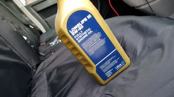

luckily i always carry a 1ltr bottle of oil in the van. this one come with the van from new from the dealer.

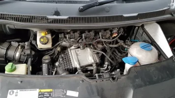

So lets look at the engine bay . . . No too dirty yet, this is the layout for the 2.0ltr 204ps diesel.
Checking under the filler cap we see no white emulsified cheese, this is probably due to the 4 or more hours a day of engine running i do keeping the temps up so the gunk doesn't form in the filler neck.

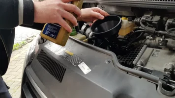

So its time for a topup.

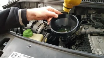

A small funnel helps with filling and keeps the engine free from drips and spills, the whole 1ltr was added and left for a few minutes to settle into the sump.
Note that the engine was already warm, this helps the new cold oil flow into the sump quicker . . . .

The oil recommended by the dealer is Castrol Magnatec 5w 30 fully synthetic, long life 7lt's of it per oil change! (Or any oil that confirms to VW505/507.)
or
Volkswagen recommends Castrol EDGE Professional Longlife III 5W-30 and Longlife IV FE 0W-20
25K miles oil service period if set to long-life as the sump has an oil-quality sensor that monitors the soot/gunk level of the oil and adjusts the MFD service readout.
