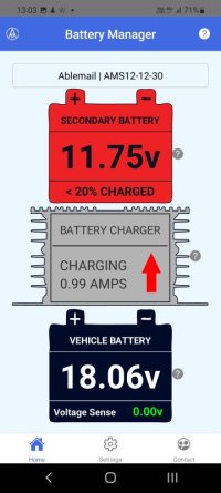

My main gripe now is what seems to be poor solar charging performance. I have the BT monitor and if it is right the input voltage flips to solar with ignition off but only getting 1 amp in the blazing sun from a 160w panel!
Another battery damaged now perhaps.
Vehicle Battery 18.06V!!?? Is that with engine running? I know the smart alternators put some funny voltages out but thet seems a little high to me!
Yeah it must be some glitch with their basic app. It's the solar voltage when my ignition is off it replaces the starter batt voltage

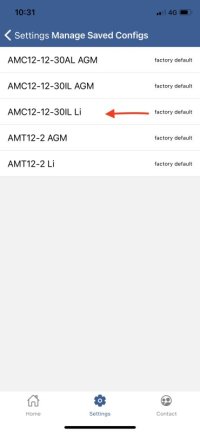

So I managed to pick up a used BT dongle used once off Ebay for £40.
Connected it up to my 12-12-30 and low & behold in the settings there now appears to be several pre-set charge profiles, inc Lithium in the app.
Just cos I'm a bit cautious (rather than diving in & changing it) I emailed Ablemail & they confirmed yep it's in there now as an option.
Happy days... the BT dongle is Ok ish IMO, & the app is continuing to be developed according to them
Hi all. Currently trying to get my 12-12-30 charger to work with lithium. Unfortunately on the app there seems to be no saved configurations for me to apply. Any ideas?? Can I manually enter the profile? If so has anyone got any values to input?
