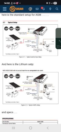

On my previous one you had to join the orange and green wire together to select the lithium profile.
See below...
You can download the install guide from red arc to double check for your specific model number.
Brilliant, thought I was going mad trying to find the switch. The wire thing looks straight forward enough though.
