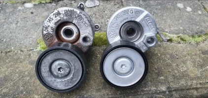

I had almost exactly the same symptoms, noise-wise and temperature related.
But after performing some checks I have discovered the shift of alternator tensioner pulley in relation to the belt itself(obviously disregard visible wrench socket)
As with increasing temperature the noise was disappearing I kept on ignoring the symptoms until I got to this stage:confused:
Once I replaced my alternator belt and its tensioner the noise went away:thumbsup:
€90=£76 well spent and invested:)
Lesson for future reference, any concerning symptoms should always be diagnosed asap and never ignored.

I can see what you're referring to, but are you saying the belt went out of alignment because of that tensioner failing, or is it out because the belt has failed?
Plus, now I can see your picture of a tensioner, it's not hard to work out which part is failing. Look at the water corrosion marks coming from the adjuster bearing.

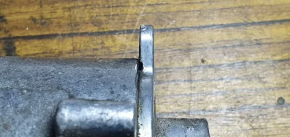

The original cause of my issue was alternator belt tensioner wear. Basically it wore out its own "guiding slide" and that wear allowed the pulley to drift/shift out of alignment. But that misalignment is only visible/present when tensioner is deflected(belt is sitting on it). As a result of only 3/4 of the belt width being in contact with the pulley the belt itself has split and therefore started to produce "squeaking type" noise.
I think I have the photo of this wear on the tensioner somewhere, once I find it I will post it here:thumbsup:

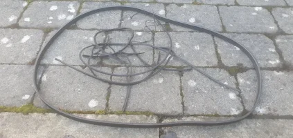

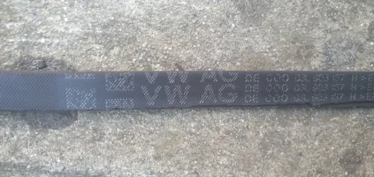

Just to clarify even further I haven't noticed that shift in first place and I have replaced the belt only on my first attempt. Next day I have performed my own verification inspection and I have discovered tesioner pulley shift.
Photo below shows new belt and old tensioner after 1 day of driving the vehicle.
It is the same photo I have posted before but I wasn't precise enough in my previous post, sorry:thumbsdown:
My squeal comes from the belt rubbing on the tensioner inside guide wall. Look at the photo and circled you will see a gap on the outside(green arrow) but it's touching on the inside(red arrow).
As this tensioner has v guides the belt can only sit in one place, so either the belt is too wide or the tensioner is badly designed and the inside guide is too narrow?

Or your tentioner is worn, forcing it off centre.

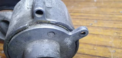

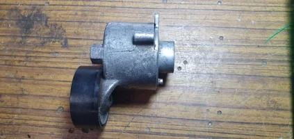

Sorry for continuing off topic, but it might be useful for others and this is very easy to diagnose from the top(once the bonnet is up;)).
Photos of my faulty alternator belt tensioner below.
