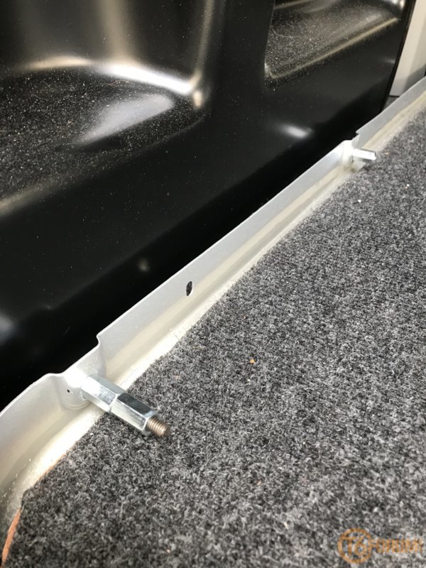

Hello, I had this very same problem with my second hand 2014 T5.1 panel Sportline.
I too found the driving position very uncomfortable having come from a Kombi, obviously without a bulkhead.
I decided the best option and cheapest option was to move the two part bulkhead backwards (in my case 40mm).
There are 18 M6 nuts holding the bulkhead in position on captive threads. Then another 5 or so holding the upper and lower parts of the BH together.
The BH is attached to the roof in the cab area under a plastic strip which is easily removed by prising it off with a flathead screwdriver . There are 4 or 5 torx screws which need removing.

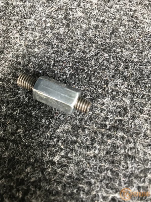

To achieve the spacing I attached one 20mm stud connecting nut to each of the captive threads. (see image).
Then cut 18 lengths of high tensile steel M6 stud to approx 35mm long.
These were then wound through a second connecting nut (see image) leaving about 7mm exposed either end of the nut. This was then wound on the first connecting nut.
All I did then was re attach the BH lower part first. Hey presto the whole BH is now 40mm further back allowing the drivers seat to go back and recline into a much comfier position.
I hope the images attached help.
The only problem now is I have a 40mm gap all round the BH. I intend to fill this with sone pipe lagging foam or
