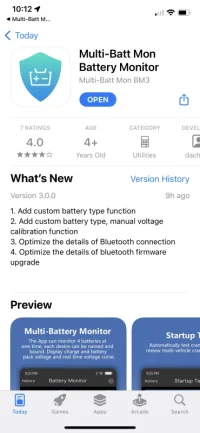

Just FYI, there’s both an app & firmware update out for the BM2. This allows you to set your battery type:- lead acid/AGM/custom
Well, I have Firmware V8 and app V3.2.3 and i cant find how to choose from those battery types. BTW which should we select?
Just had another look.
My Ablemail AMT 12-2 does not seem to be charging the starter :(
Go to the cog symbol top right, select “Bluetooth device” and your battery should be displayed on that screen. You can edit the battery & select type.

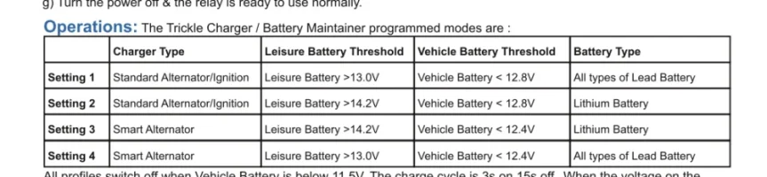

AMT12-2
kicks in when starter under 12.4v and LB is above 14.2v (profile #3)
3sec ON - 15sec OFF charge bursts 3A - Profile#3
if you try to top up the starter too much, the DC-DC charger will kick in.
you just want to keep the starter at its normal rest voltage of 12.2v ish.
and counter act the long term discharge.
AMT12-2
kicks in when starter under 12.4v and LB is 11.5v to 14.2v range.
There’re actually 8 modes now. Each of the 4 documented modes shown above has a “heavy duty” mode.
So there’s modes 5-8. These are the same as 1-4 but give a 9second on instead of the 3 seconds.
Mine is set to mode 7, which is the same as mode 3, but gives a 9 second burst rather than the 3 second on-time of mode 3.
The new BM2 firmware also allows for a custom battery profile, which I need to play with. This will allow us to create a profile for a stop/start battery that shows 12.2V as “normal”

My Amt12-2 is set to mode #8.
As above mode 4-8 is heavy duty version of 1-4.
Mode 3 needs the leisure battery to be above 14.2v to start the trickle charge....
Because I don't have solar connected all the time my lithium never sits at above 14.0v unless the engine is running.
So.
I use mode#4 or #8..
Which needs a leisure battery voltage of 13.0v or above.
This way my starter is trickle charged all the time from the lithium....as it rests above 13.0v and not just when connected to a charger or solar like mode #3.
So.
People who use mode #3 or #7 need to realise that the charge profile won't start until the leisure battery is above 14.2v..
That means active solar charging or EHU charging..
Mode 3 won't charge if the van is just sitting doing nothing with no solar.
The only thing to note is that the leisure battery will top up the starter every vdrive cycle... As it will always be running.(in mode 4 or 8 with a lithium battery)
That's fine for me as I have s large lithium lb and a good DC-DC charger to replenish the charge very fast every new drive cycle.
Mode 3 is designed to kick in when a charger is connected.
