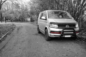

Hi, I am thinking of doing exactly the same. Any chance of a couple of photos?

Cheers. Yep, got them powder coated. Did a cracking deal with my local wheel refurb company. £200 for the refurb and powder coat, £550 for the tyres fitted, and loan wheels for 3 days. Really good value.

They look really good actually - although I would want a spacer on the rear to bring them out abit so they fit like my modular steels.

Hi there, your van looks great. Could tell me what bull bar and light setup you have please? Looking to do this to my own van.

Stance on that looks spot on! What setup do you have there?
