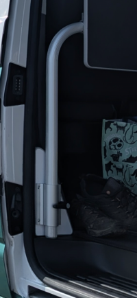

We have a camper king conversion and the table for the passenger swivel seat has just been fixed with some self tappers in the composite board.
What's the best fixings for things like this?
I was looking at t nuts, but that a) involves a large hole, b) removing the panel.
Is there any other options for strong fixings people have used?

If you mean where the bracket attaches to the van then am not sure what you mean - please send photo
The problem with self tappers and the likes of above are they are only strong in the attaching direction.
For the likes of a table on the arm, they aren't strong.
For metal I would normally use rivnuts or captive nuts on a plate on the other side.
I feel there must be a better fixing that I am missing other than screwing something directly into the composite board which is never gonna get a good fixing.
What are you wanting to use the table for? The fact that it is a mono aluminium/mild steel armed articulated fold out surface to start with will always mean there are limitations in it's stability, strength and usage. A plate of food, a laptop, a little stove maybe...
i feel like you need to get a stronger table material like solid wood perhaps. Bolt it on with t nuts and then put a nce laminated graphic over the top for the finish and to cover t nuts.
Its only ever going to be an occasional table as you mention by design.
I'm just intrigued how other people mount them?
As 4 self tapping screws will never be robust without even taking into consideration weight on the table. It's design means even rotation means you are pulling against the screws.
