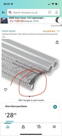

Buy another strip of kador and slide it in with your existing one. Or use a piece of rope. The extra thickness will stop it pulling out. If you use a drive-away kit you can get strips that have 2 different sizes on one side (4 & 6mm) and you just feed them both into the rail. Works on my rectangular section VW rail.
Right, yes I see what you mean, I've seen the drive away kit but didn't realise both the 4mm and the 6mm went into the rail. I think that will work.

Yep, slide the 2 marked below into the rail. Awning into the other side of the figure of 8.
Or just get a single strip like the one below and slide in with your awning kador.
