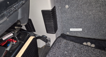

Mine is fitted under the driver's seat (internally) so intake is at the front and 1000004102.webpout to the rear of the seat. I'll try and get hold of a thermometer and get some temperature measurements.

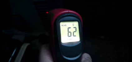

I've done some tests, so far 30mins after startup from -4c.
started at -4c
after 30mins inlet temp +4c and outlet temp +62c,
ill add the 60mins update shortly.
EDIT: TBC

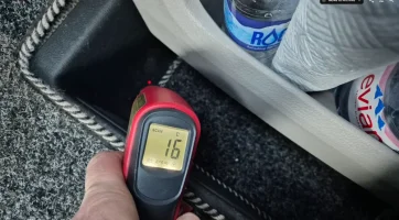

no 1hr after startup.
inlet temp now +16c,
outlet temp high 60/70s - here showing +78C,
rear internal temp raised to +15c now,

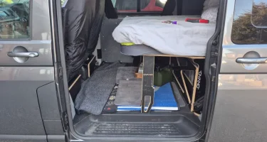

thats not bad, as with this current layout the bed makes a air pocket, so under the bed area is very warm, and it takes a while for the heat to travel to the rest of the van.

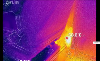

Right thanks chaps I'm clearly some sort of idiot, I tested using a Thermometer same as Dellmassive this morning and got 16.5 degress intake temp with a 78 degress out put at the vent and over 100 degress when i fired it along the tube a bit ( ooooo missus )
