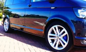

Apologies for late reply , been away all weekend in the van , here is a close up , of a dirty van and wheel !!! Currently on 245/45/19 Dunlop but have a set of Nexen Nfera waiting to go on

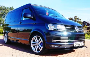

Hi @Anthony Ball after seeing your post of your starlight blue with your Amarok wheels, have also taken the same route. Hope you don't mind me copying your lead, I'm loving the wheels. Thanks for the inspiration. :thumbsup:
No probs at all , they look ace on your van , what suspension you running ? I'm looking to get mine sorted this week as I now have some spare funds !!
That's a sore subject in our house :whistle: originally and in that pic I have H&R 50mm springs on the original shocks. It's a great drop and looks great.
However the ride is not great, on the motorway and smooth roads it's fine and I can live with it. However on slightly rubbish road it's a bit crashy and harsh.
I'm trying to find a slot in the next few weeks to get it into Bognor Motors to go down the B14 route.
Mrs Simmo keeps asking me why I didn't do B14's in the first placeo_O, as ever she is right, should of done that from day one! :D:D
