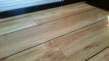

I’ll get you one, but in the meantime @JaySal had this done at Bus Stop VW (and I’ve copied):
b9e5b175-bf4e-43c3-aedb-f7a578aed7b7-jpeg.22778
Karndean flooring with the detail strips to look boat-deck like.

Good thread, I've been thinking about redoing the floor in my caravelle to a wood effect.
Edit: just found this at Kiravans. Looks good and not a bad price.
Lukavell
DITryer
T6 Legend
That looks brilliant. I had a look on Karndean website and whilst I could find loads of different types of wood effect I couldn't find one like yours with the strips.
Wills
Senior Member
T6 Legend
One of my favourite floor finishing Adam. The black strips finish it off nicely. What width are the planks as they fit nicely within the rails?
Their website isn’t that great when searching for specifics. I’m going to a local supplier to check on what’s available. The black strips are sold separately

Thanks mate. I don’t think I’d lay it again in a rush.. the pro’s make it look easy!
Something tells me the planks are 100mm and the strips 5mm, but I’d have to double-check.
I’ve just dropped the van in to the garage for coilovers so can’t measure, but remind me in a few days and I’ll let you know.

Ah, so they are 'plank' like in their application? I thought that they were more like a sheet.
Ads_Essex
Local lowlife
Moderator
T6 Legend
I’ve just checked my eBay account and it looks like the specs were:
Karndean American Oak - Knight range (KP40) 150mm x 914mm x 2mm
1 & ½ boxes.
Karndean black feature strip 5mm x 2500mm x 2mm
Just in to two packs (literally just - I think I used two or three strips).
Yup, planks, which makes them “easier to cut and fit”. I’ve used their contact adhesive in the past, which again makes for easier installation
