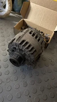

After pulling the alternator out tonight it seems my concerns of the alternator was at fault. The freewheeling pulley has given up meaning it now will freewheel in both directions and engage with the alternator.
The pulley is replaceable at very low cost, cheap special puller required.
I was looking at mine through the wheel arch and under the van, I think it’s possible to replace without removing the alternator.
Perhaps someone can confirm?
