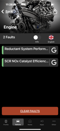

I have a t6 150 - 2018 with 120,000.
I’ve had it just about a year.
About 3 months ago I got a engine light with
These codes
It went into the garage and was
told it needed a software update, which they did.
100 miles later the light came on again- same codes. Also had a warning saying Addblue needed filling in 600miles, but the OBC was saying 4000miles (as it had just been filled)
Off to the garage again for DPF to be cleaned and checked. Everything looked good.
Light came on again 100miles later.
Back to the garage.
I was told that when in re-gen (not sure what that is) it ran really poorly like it was miss firing, but ran fine out of re-gen.
I’ve been advised the fix could be replacing the injectors, but no guarantees or I could remap it and delete the Addblue, which I’d prefer not to do.
Has anyone come across these issues?
Any advice welcome.
