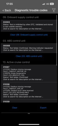

Having an issue with ABS when ignition is turned on followed by front assist then stop start with engine start.
Vehicle is 2019 T6 102 2L TDI
Initially was just ABS fault that occurred last month when driving home on an extra wet day.

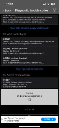

Checked error with diagnostics but not great results - see attached
Removed all 4 ABS sensors one at a time, cleaned them and measured resistance just to try work out if there was an issue. Suspected rear drivers as it measured open which I’ve now swapped but problem remains the same. Just tried firing up with the sensor disconnected and errors the same so possibly barking up the wrong tree.
