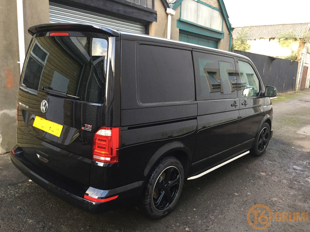

Before and After Pictures

B14's on my T32 4-Motion, this was when the bus was new, coilovers at the top of their adjustment so roughly a 50mm drop from standard.
