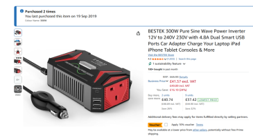

if you want a decent one. . . I've got a couple of these and they are great . . plus PURE sine wave.
again for 100W plus it needs to be clipped to the battery.

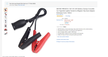

you can also get high power 12v unfused socket to croc clamps. . . that what i used to do.
