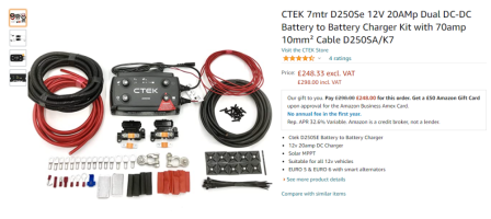

You could look at fitting one of the combined units . . . (charger & solar)
This example has a 30A DC-DC charger - so way better than just a VSR relay, plus it has a built-in MPPT,
so just connect your mobile solar panel etc into it. . . .

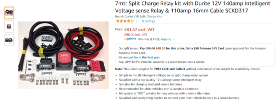

As far as I am aware he will be ok with a VSR in a T5, won't need a DC-DC. Just am MPPT for the solar.
on a T5, you could fit a VSR kit like this. . .l
Then get any mobile solar kit ( that will come with a PWM or MPPT pv charge controller )
and just connect that to a fused Quick-Disconect which is connected to your new leisure battery . .
examples of those here - Battery Chargers - How I Did It -
