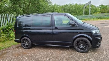

Hi looked through alot of posts but still not sure i have 20" alloys with 275/40/20 all round now the fronts want replacing so was going for 265/40/20 not sure but can i put 265 on the rear as well when they need replacing i think the wheels are staggered the van is a T32 so will 104y be ok
Simon
104-rated tyres are suitable for a T32 (minimum rating is 103).
What widths are your staggered wheels?
Do you know the make/design of the wheels? If not, someone will probably be able to identify them if you post a pic of them.
Those look like Supermetal Tridents, but, as far as I can tell (after only a quick google search), they only sell those in 9" width. Are you sure they're staggered?
The rear tyre does look a little more stretched than the front, so perhaps I've mis-identified the wheel. ¯\_(ツ)_/¯
