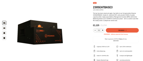

going on above you will need 2kWh battery capacity (about 200ah lithium )
that means:
look at 100-250ah of lithium battery, - Lithium LifePo4 12v Batteries - Time For An Upgrade?
look at a 1000w-2000w inverter, - [Guide] 12v/240v Power Inverters -- How I Done It --

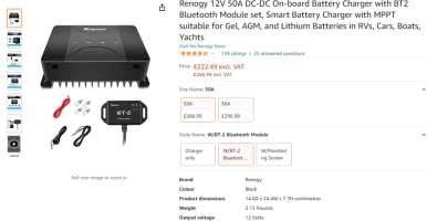

look at a 20A-50A DC-DC charger, - [Guide] DC-DC Charger (for leisure battery) -- How I Done It --

get this dc-dc charger: - https://amzn.to/3vvS0vO
get this lithium battery: Roamer
