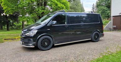

Here picture of my general grabber at3 235/55 R18. And I have the Eibach -30/40mm lowering springs. I am super pleased with the tires, specialty on gravel roads, works fine also in the city.

I have run 235/55/18 General Grabber AT3s since 2017. Various wheels and never had any issues. Ran 235/60 for a while but these did scrub on lock while the suspension was compressed.
235/55 on as we speak. For an AT they're quiet and handle well.
Perfect stance!

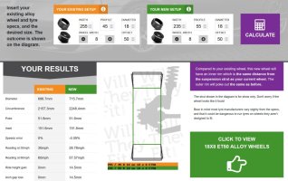

Can I ask you about the height of the rear wheel arch?
I have my Cali lowered with Eibach Pro Kit (ca. 40mm) and the height on the rear axle is 72 cm from wheel arch to the floor.
Using the Fitmen Calculator it shows a Diameter from 71,57 cm..
I would love to put them on the Cali, but I dont think they will fit..
Thanks!

Did you try this ?
