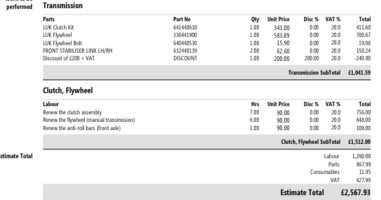

Had to get breakdown to rescue me the other day when the clutch went (goes down but not back up, oil leaking out when refilling). Taken to an RAC approved garage as I was 150 miles from home and had no idea where would be good or bad. Quote back from garage was £2600 for the parts and labour. Seems way more than what I'm seeing elsewhere now on forums etc but happy to be told that's correct. For a T6 T32
LUK Clutch kit, LUK Flywheel, Flywheel Bolt, Front Stabiliser link coming in just over £1000, then just over £1500 for estimated 14hrs labour

Here’s the quote. Discount was applied because I showed them the same parts for cheaper elsewhere lol
It looks like they are pricing the DMF and Clutch renewal as individual jobs when in fact they are both done at the same time.
Should be no more than 7 hours work.
You might want to point out that they are not renewing the ARB, they are removing and reinstalling it.
In old money that's called taking the p1ss.

@matt_ew I hope you will ask them how it takes 6 hours to change the flywheel when the clutch is already being changed.
What he said....
Once the gearbox is out, it's a few bolts to drop the flywheel... Half hours work.
Even if you round it up to an hour.
